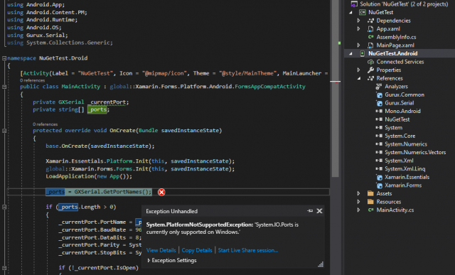

You imply that I can add NuGet packages to my Android project and it will work. Maybe this is ok for network comms but this does not seem to be the case for a serial port connection, which as you said earlier, needs extra work to be done. Android needs special handling to access the serial port (as a USB port), as is done in the GXSerial.open() method (see https://github.com/Gurux/gurux.serial.android/blob/master/gurux.serial…)
For .NET the NuGet packages use the System.IO.SerialPort class which Android does not support. This was the reason I started using the Android versions of Gurux modules and importing then into my solution.
I wrote a quick test solution using NuGet packages in an Android project and got the result in the attached image.
Please tell me if I am misunderstanding something about this,as I cannot see a way to use NuGet packages directly in an Android (i.e. 'xxx.Android') project.

Yes, there is no native serial port support for Android. This is not big work because we have done this already and know what to do. I'll ask if some of our clients if this is needed. If they do we can add support for Android to C# serial port component quite fast.
