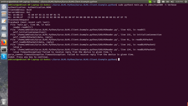

We are using the DLMS Python Library from the github and were able to run it. However, we are facing some issues with getting data and are also seeing frequent disconnections.
Here is a screenshot
6 years 9 months ago
Please, don't post an image if you have problems. It's easier to check bytes from the textual trace.
Meter is replying, but few bytes are missing from the begin of reply. What Linux distro you are using?

same problem. This is my log.
ClientAddress: 0x10
TX: 11:07:15 7E A0 07 03 21 93 0F 01 7E
RX: 11:07:30 81 80 14 05 02 02 00 06 02 02 00 07 04 00 00 00 01 08 04 00 00 00 01 6F EF 7E
6 years 8 months ago
This is strange. Data is correct but few bytes are missing from the begin of the packet. Is your Ubuntu 64 or 32 bits?

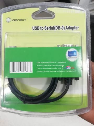

Do you have a web link or pic from the used converter?
ambimat
Sure.
Sure.
Here is the image of the packet.
This same converter works well when we use an off-the-shelf serial software like hterm. It also works fine when we send the hex data from our own python code.
