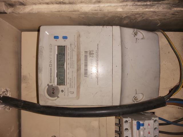

Good morning everyone,
i'm trying to make a static counter (CX2000-4) to Smart Meter from a Sagem CX 2000-4
is there any solution to read values ?
Connection type is DIN.
Thank you.
6 years 9 months ago
Your meter is using IEC 62052-11. It's a text-based protocol and it's quite easy.
Try to send /!?\r\n to the meter using an optical head. You should receive meter info, like a serial number.
If meter is supporting Mode A, it'll send the current readout.
skivn
i don't have an optical head at the moment, it's very expensive ...
is there another solution ?
Thank you
Sorry to say but no. I agree optical heads are very expensive.
