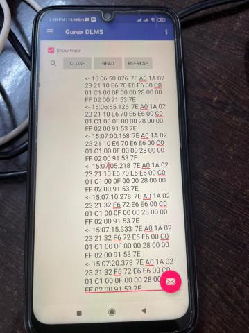

I launched the above suggested demo to read DLMS meter, and found data on read and refresh.
Can you please suggest what these data are or is it possible to extract meter data from the data i received.
Also let me know if anything is missing from my side,
Hi, I launched the above suggested demo to read DLMS meter, and found data on read and refresh. Can you please suggest what these data are or is it possible to extract meter data from the data i received.
That is trace. Un-check "Show trace" and you can see actual values. I propose that you download GXDLMSDirector and read your meter with it. You get an idea of what DLMS objects look like and you have a better understanding from DLMS.
In DLMS you don't just read value. You need to establish the connection to the meter and then read what you want to read. This is a release request that closes the connection.
can you please suggest how to convert the above received value to readable one, unchecking show trace simply wipe the screen.
i Just want to retrive meter value in redable format, but receiving these data
( <- 15:51:20.469 7E A0 23 03 41 BA 26 25 E6 E6 00 62 15 80 01 00 BE 10 04 0E 01 00 00 00 06 5F 1F 04 00 00 1E 1D 00 80 24 38 7E)
in log and failed to parse it.
Does these data have meter vaue if yes, please suggest how to parse them.
You should check our libraries and use them to read the meter.
