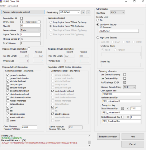

Unknown logical name is coming because logical name is invalid. You need to replaca "OBIS CODE for parameter" with the logical name and attribute index. For example "0.0.1.0.0.255:2"
Your block cipher keys are different than in your picture. You need to change -A and -B arguments to use correct keys. If the password is RES_UnicastAssoc then the -A and -B argument is 5245535F556E69636173744173736F63

Hi, You need also to add the…
You need also to add the following arguments:
-c 32 -P ABCDEFGH.
You need also to change the authentication (-A) and block cipher (-B) keys to the correct ones.
So the command line should look something like:
python main.py -S /dev/ttyACM0 -c 32 -a Low -P ABCDEFGH
-C Authentication -A D0D1D2D3D4D5D6D7D8D9DADBDCDDDEDF -P 6566676869707172 -B 000102030405060708090A0B0C0D0E0F
