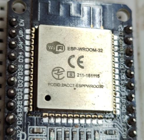

Hi, Is this the exact model…
Is this the exact model of your ESP32 and this is not for eaxmple ESP8266? This is now tested with ESP32 and ot worked without problems.
Hi, This is the model I'm…
This is the model I'm using it's an esp- wroom-32 to be exact.
Before,after compilation when i uploaded the code to the board... nothing happened.... [using a TTL converter and rj11 to usb cable (data cable) to connect with a single phase energy meter from L&T].......so to see up till where the code was being executed....i added serial.print() statements in the client.ino file
That's when the above error code started appearing
I have taken the pic of my board ,shared below....
Thank you
