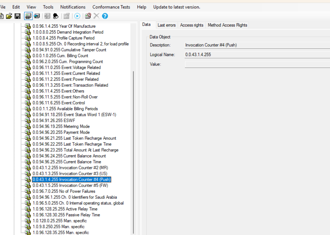

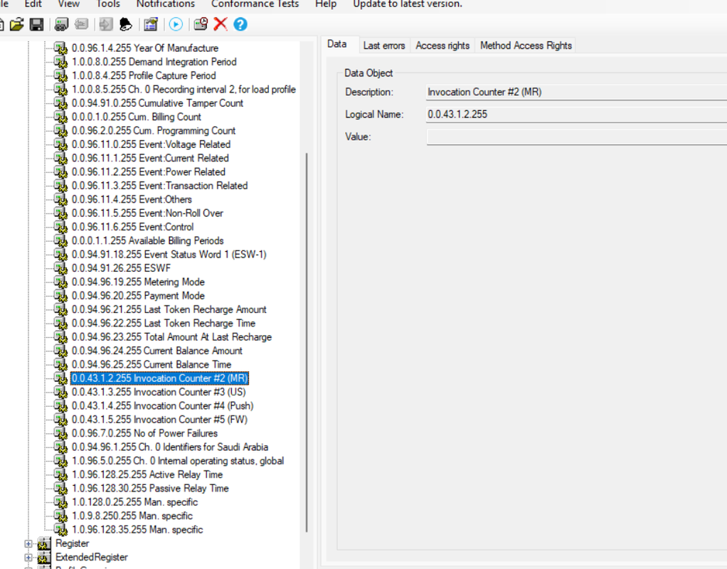

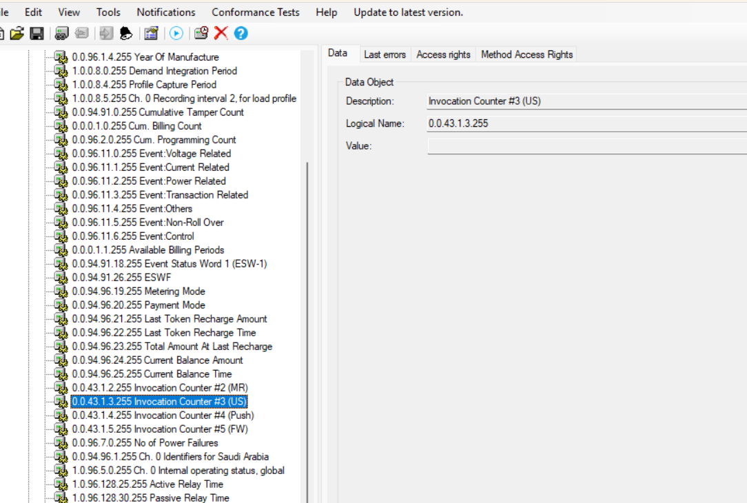

Sir, When I read the meter…

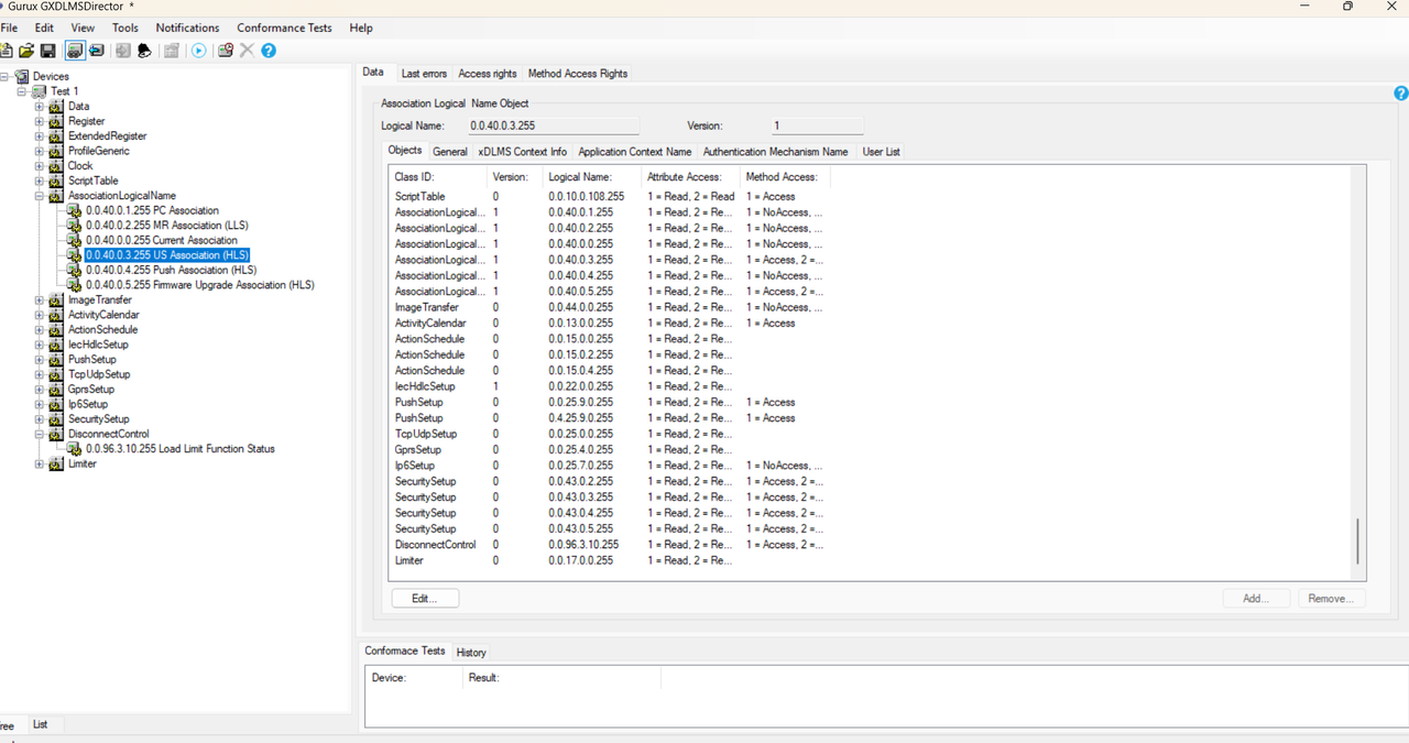

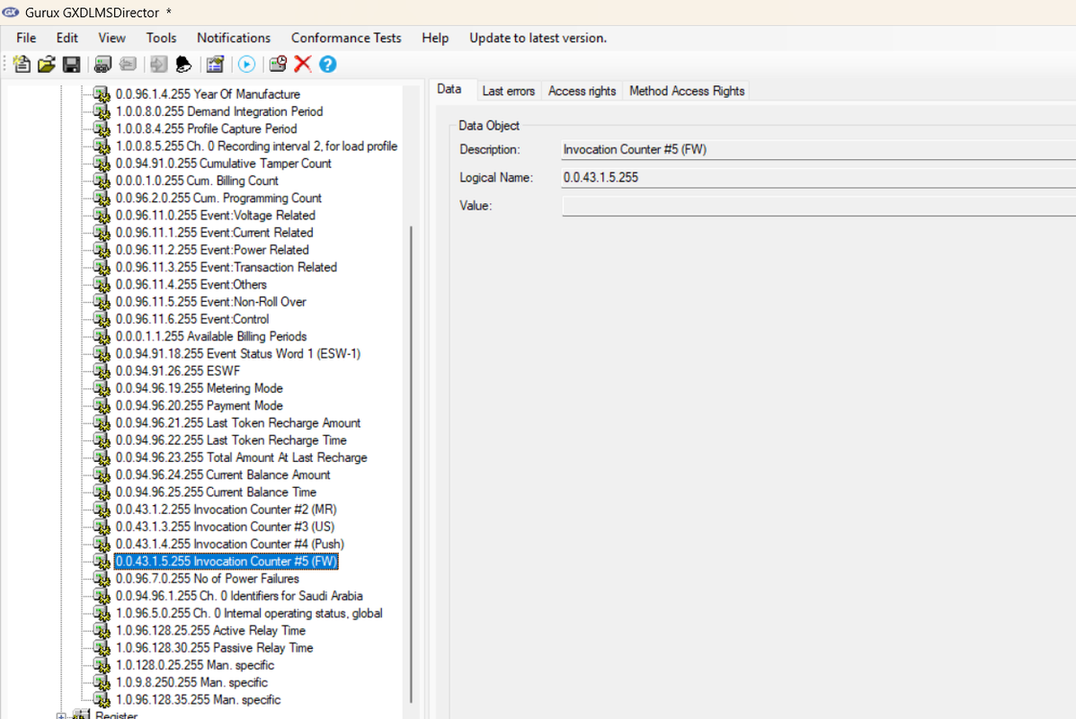

Sir,
When I read the meter through Gurux DLMS Director and opened the Data section af
ter a successful reading, the software displayed multiple invocation counters. The following logical names were available:
Invocation Counter #2 (MR): 0.0.43.1.2.255
Invocation Counter #3 (US): 0.0.43.1.3.255
Invocation Counter #4 (Push): 0.0.43.1.4.255
Invocation Counter #5 (FW): 0.0.43.1.5.255
To comprehend what I see when connecting with the meter through GuruXDLMS director, I show you this :
image.https://i.postimg.cc/B6dgKN62/Screenshot-2025-09-03-192517.png
https://i.postimg.cc/8C7MmWx4/Screenshot-2025-09-03-192708.png
https://i.postimg.cc/CK8dK4W3/Screenshot-2025-09-03-192719.png
https://i.postimg.cc/rFW8xph4/Screenshot-2025-09-03-192738.png
2 months 1 week ago
Hi, You need use the same…
You need use the same invocation counter with Android app. Select "Meter Settings" and "Security" tab. Then set the used value to the Invocation Counter, e.g. 0.0.43.1.2.255.

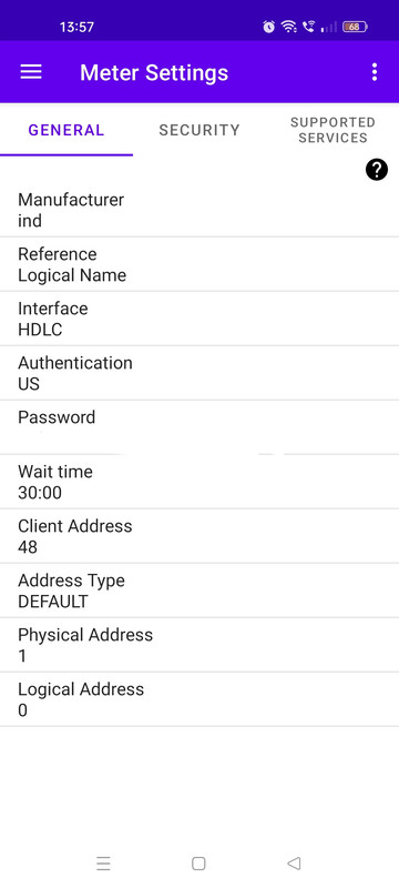

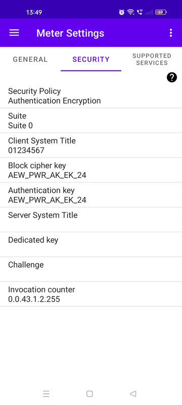

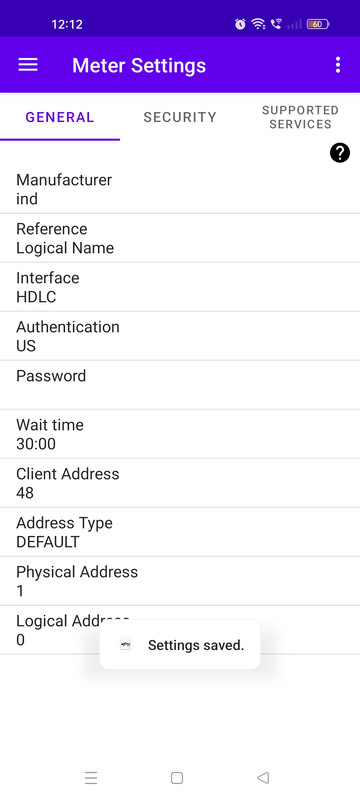

Sir, As per your suggestion…
Sir,
As per your suggestion, I have configured these properties in the app. Please review them, I’ll show you now :

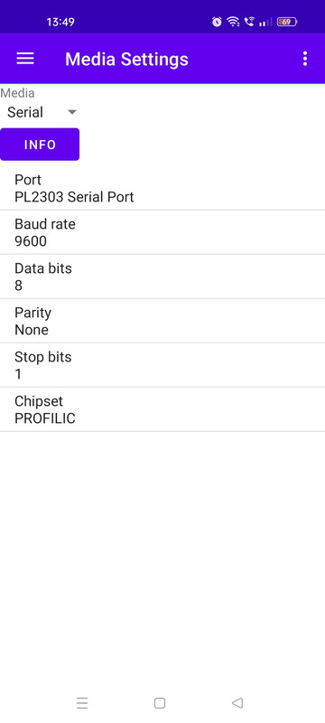

This is my media setting in android app :
https://i.postimg.cc/2ScmFRFn/Screenshot-2025-09-04-13-49-34-52-292f262…
These are my meter settings. I have also entered the password in place of "password":
https://i.postimg.cc/Jh0Z7kQZ/IMG-20250904-140116.jpg
This is my security setting with invocation counter:
https://i.postimg.cc/fWpHGwD8/Screenshot-2025-09-04-13-49-50-79-292f262…
This is my security setting with different invocation counter:
https://i.postimg.cc/RC6dQjKK/Screenshot-2025-09-04-13-57-33-07-292f262…

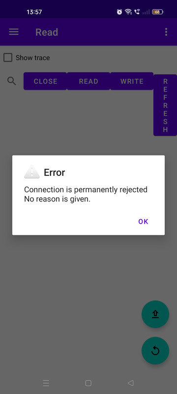

Once I did this, I read the data, and the output was:
https://i.postimg.cc/SswWvxC8/Screenshot-2025-09-04-13-57-59-86-292f262…
I tried using different invocation counters as shown above. When I run it with an empty invocation counter, it gives me an "invalid logical name" error andI have modified the client address, testing with both 48 and 30.
2 months ago
Hi, You must use IC 0.0.43.1…
You must use IC 0.0.43.1.3.255 to US.
The reason is that one of your settings is different from what the meter expects.
Compre your settings with GXDLMSDirector.

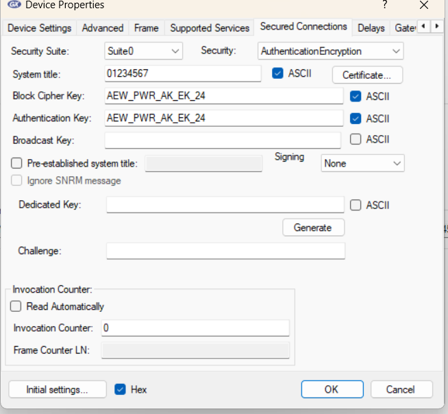

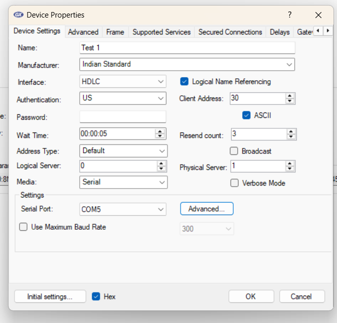

Sir, This is the meter…
Sir,
This is the meter configuration in Gurux GXDLMSDirector. Using this configuration, I was able to read data, and I entered my actual password in place of "password":
https://i.postimg.cc/02mChFkm/Screenshot-2025-09-04-153122.png
https://i.postimg.cc/25Hd4fGp/Screenshot-2025-09-04-153141.png
https://i.postimg.cc/RC1F8Trh/Screenshot-2025-09-04-153202.png
But when I use the same parameters in your Android app, it does not work. I have already shared the Android configuration in the previous forum post.

2 months ago
Hi, Select Info. What is…
Select Info. What is your application version? Make sure it's 3.0.4 so we are using the same version.
Select "Show Trace" and add a hex trace here as text so I can check where it fails.

2 months ago
Hi, Everything looks correct…
Everything looks correct. One of the settings is different from what the meter expects.
Can you connect with GXDLMSDirector and add a hex trace here? You can access it by selecting the top menu "View", then "Log", and "View Log".

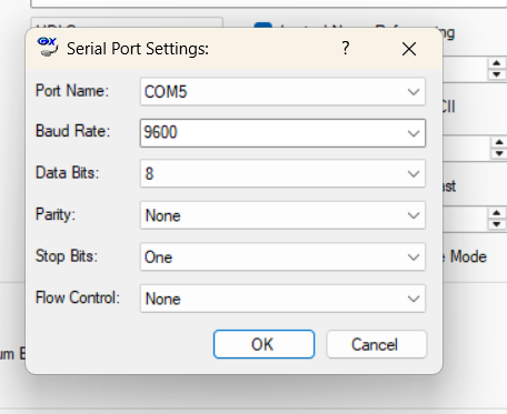

Sir,
This is the trace of gurux GXDLMS Director :
19:23:02 Initializing serial connection.
19:23:03 Send SNRM request.
7E A0 07 03 61 93 69 47 7E
19:23:03
7E A0 20 61 03 73 05 9E 81 80 14 05 02 03 40 06 02 03 40 07 04 00 00 00 01 08 04 00 00 00 01 B7 29 7E
19:23:03 Parsing UA reply succeeded.
19:23:03 Send AARQ request.
7E A0 6B 03 61 10 2A FF E6 E6 00 60 5D A1 09 06 07 60 85 74 05 08 01 03 A6 0A 04 08 30 31 32 33 34 35 36 37 8A 02 07 80 8B 07 60 85 74 05 08 02 02 AC 12 80 10 04 6E 4C 12 4D 09 27 59 09 14 49 26 55 13 1D 6D BE 23 04 21 21 1F 30 00 00 00 00 40 D0 27 82 F4 90 B4 12 35 B8 14 B7 87 C4 B0 29 25 C1 E0 53 2C AE 3C F6 CB 50 D9 12 7E
19:23:03
7E A0 77 61 03 30 AD 6C E6 E7 00 61 69 A1 09 06 07 60 85 74 05 08 01 03 A2 03 02 01 00 A3 05 A1 03 02 01 0E A4 0A 04 08 41 4C 4C 00 00 7A 26 C4 88 02 07 80 89 07 60 85 74 05 08 02 02 AA 12 80 10 31 45 4E 45 53 41 53 5F 50 36 77 52 4A 32 31 46 BE 23 04 21 28 1F 30 00 00 00 00 A7 40 70 C5 D3 94 F8 CD 87 44 E0 53 31 B2 36 B4 2F 9B CE AC 96 F3 27 E6 39 40 79 BC 7E
19:23:03 Parsing AARE reply succeeded.
19:23:03 Authenticating.
7E A0 3E 03 61 32 7B 46 E6 E6 00 CB 30 30 00 00 00 01 6B F9 11 12 AB D0 BD A6 87 76 06 52 35 31 97 51 9D 2F E8 78 22 12 C1 DA 66 C7 28 E6 3E 1D 3D A3 08 86 FA A4 F9 17 FB B9 B3 D3 B2 08 AC 7E
19:23:03
7E A0 37 61 03 52 0E 3A E6 E7 00 CF 29 30 00 00 00 01 7A A2 25 2F 20 0E AF E7 90 E1 BA F3 F4 A3 49 A5 51 B3 C6 FA 01 6E FF E6 D5 26 F0 89 34 0E 3B 13 79 D3 0D B1 AB 2D 7E
19:23:05 --- Collecting objects. ---

Sir, I am currently working…
Sir,
I am currently working with version 3.0.5 and I am passing the parameter, which can be seen in the screenshot below.
https://i.postimg.cc/Z5BHwTNY/Screenshot-2025-09-08-12-12-39-28-292f262…
https://i.postimg.cc/zfysSZzT/Screenshot-2025-09-08-12-12-46-16-292f262…
but it is not able to read data but it show connected the traces its show me is :
Connecting /dev/bus/usb/001/002
Security level: Authentication Encryption
Block cipher key: 41 45 57 5F 50 57 52 5F 41 4B 5F 45 4B 5F 32 34
Authentication key: 41 45 57 5F 50 57 52 5F 41 4B 5F 45 4B 5F 32 34
<- 11:58:30.695 7E A0 07 03 21 93 0F 01 7E
-> 11:58:30.749 7E A0 20 21 03 73 73 98 81 80 14 05 02 03 40 06 02 03 40 07 04 00 00 00 01 08 04 00 00 00 01 B7 29 7E
<- 11:58:30.759 7E A0 2B 03 21 10 FB AF E6 E6 00 60 1D A1 09 06 07 60 85 74 05 08 01 01 BE 10 04 0E 01 00 00 00 06 5F 1F 04 00 62 1E 5D FF FF 88 55 7E
-> 11:58:30.879 7E A0 37 21 03 30 6C 7C E6 E7 00 61 29 A1 09 06 07 60 85 74 05 08 01 01 A2 03 02 01 00 A3 05 A1 03 02 01 00 BE 10 04 0E 08 00 06 5F 1F 04 00 00 00 10 03 40 00 07 D1 F0 7E
<- 11:58:30.894 7E A0 19 03 21 32 6F D8 E6 E6 00 C0 01 C1 00 01 00 00 2B 01 03 FF 02 00 B0 AA 7E
-> 11:58:30.963 7E A0 15 21 03 52 5D 8A E6 E7 00 C4 01 C1 00 06 00 00 00 00 7D 18 7E
Invocation counter: 1
<- 11:58:30.992 7E A0 07 03 21 53 03 C7 7E
-> 11:58:31.052 7E A0 20 21 03 73 73 98 81 80 14 05 02 03 40 06 02 03 40 07 04 00 00 00 01 08 04 00 00 00 01 B7 29 7E
<- 11:58:31.069 7E A0 07 03 61 93 69 47 7E
-> 11:58:31.131 7E A0 20 61 03 73 05 9E 81 80 14 05 02 03 40 06 02 03 40 07 04 00 00 00 01 08 04 00 00 00 01 B7 29 7E
<- 11:58:31.153 7E A0 6B 03 61 10 2A FF E6 E6 00 60 5D A1 09 06 07 60 85 74 05 08 01 03 A6 0A 04 08 30 31 32 33 34 35 36 37 8A 02 07 80 8B 07 60 85 74 05 08 02 02 AC 12 80 10 07 1E 6A 53 60 1A 21 07 15 6C 43 6A 78 6A 35 24 BE 23 04 21 21 1F 30 00 00 00 01 A9 F8 D0 12 A2 8F A2 8A 87 14 E7 0E CB C7 3F 66 47 65 D2 6B 76 68 7D 86 94 D9 3F C8 7E
-> 11:58:31.427 7E A0 77 61 03 30 AD 6C E6 E7 00 61 69 A1 09 06 07 60 85 74 05 08 01 03 A2 03 02 01 00 A3 05 A1 03 02 01 0E A4 0A 04 08 41 4C 4C 00 00 7A 26 C4 88 02 07 80 89 07 60 85 74 05 08 02 02 AA 12 80 10 31 45 4E 45 53 41 53 5F 50 36 77 52 4A 32 31 46 BE 23 04 21 28 1F 30 00 00 00 01 B5 A3 E2 70 3E 0A A6 D7 60 52 90 4C 7F 07 CA 5A 5B DB 50 AB 7A 40 B3 A9 6A 8E 6D 72 7E
<- 11:58:31.462 7E A0 3E 03 61 32 7B 46 E6 E6 00 CB 30 30 00 00 00 02 7A D3 CC 37 01 EE B1 C3 A3 D6 8C 4D 73 55 AE 1B 7B 3D D2 9A 19 4D CC 94 D6 87 B2 D1 48 59 1E 29 C7 0D 9C 86 19 BE A3 0F 87 10 BD 06 47 7E
-> 11:58:31.632 7E A0 37 61 03 52 0E 3A E6 E7 00 CF 29 30 00 00 00 02 4C 23 33 DB 39 F8 C8 5C 56 EF 73 D6 1D 3D 84 B0 31 B3 FE 84 DF 17 3E 47 5F 82 9F 89 01 41 60 72 D5 FA EB 17 EB DD 7E
2 months ago

2 months ago
Sir, I am using the latest…
Sir,
I am using the latest version 3.0.5 and my android phone version is 13
Suraj Pandey
2 months ago
Sir,
2 months ago
Hi, Your phone can’t keep up…
Your phone can’t keep up with updates to this trace that often. This is now fixed, and the trace UI is updated only 5 times/second. Get the latest version.
If it is still causing problems, select Info and add the Android Version and used SDK here so we can get the same Android version that you are using.

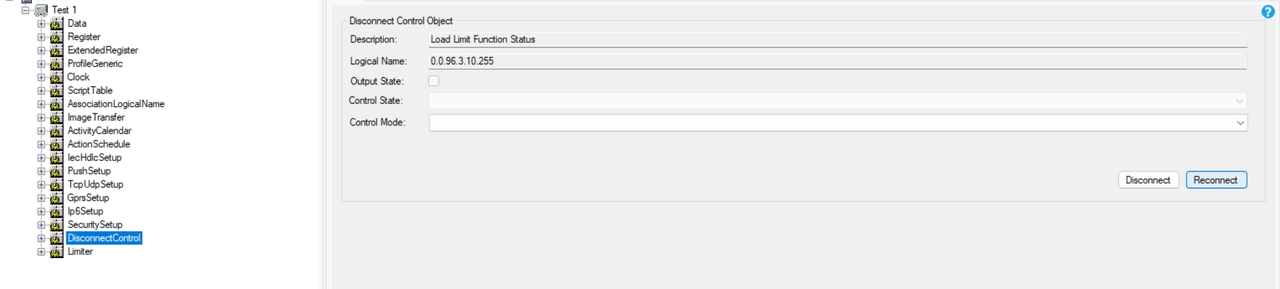

Suraj Pandey
1 month 4 weeks ago
Sir, In the Gurux DLMS…
Sir,
In the Gurux DLMS Director application, it shows the option: Disconnect Control:
https://i.postimg.cc/VLxgjPjT/Screenshot-2025-09-11-123053.png
I also checked the access rights, and it shows the following:
https://i.postimg.cc/8Pw2mHpM/Screenshot-2025-09-11-125503.png
After making some modifications, the application now displays different logical names. However, I am still unable to access the corresponding values. I have also provided a video for reference
https://drive.google.com/file/d/134UadiIFalVnZUjugqFmq6oTGeUEua_v/view?…

This is my Gurux DLMS Director frame:
<AssociationRequest>
<ApplicationContextName Value="LN_WITH_CIPHERING" />
<CallingAPTitle Value="3031323334353637" />
<MechanismName Value="High" />
<CallingAuthentication Value="721D1C4A3D3917674556197967383337" />
<!-- Decrypt failed. Invalid authentication tag. -->
<!-- Decrypted data:
Security: AuthenticationEncryption
Invocation Counter: 0
# Error: Failed to decrypt data.
<glo_InitiateRequest Value="300000000040D02782F490B41235B814B787C4B02925C1E0532CAE3CF6CB50" />
</AssociationRequest>
</PDU>
</HDLC>

1 month 4 weeks ago
Hi, If you change the…
If you change the authentication level, you need to read the association view again. The access rights vary between authentications.
Select the meter manufacturer before you modify the settings. Selecting a new meter manufacturer might overwrite existing settings.
Suraj Pandey
1 month 4 weeks ago
Sir, In Gurux DLMS Director,…
Sir,
In Gurux DLMS Director, we use the same meter settings and other configurations, and we are able to read the data properly. Additionally, with the use of the Disconnection Control, we can successfully perform reconnection and disconnection operations.
However, in the Android application, although the Association View is accessible and logical names are displayed, the actual values are not shown. Furthermore, I have not used the Disconnection Control feature in the Android app."
1 month 4 weeks ago
Hi, You need to press the…
You need to press the Refresh button to read the association view again. You are using the association view that you have read, which has different authentication settings.
After you do that, the connect and disconnect buttons are activated.
